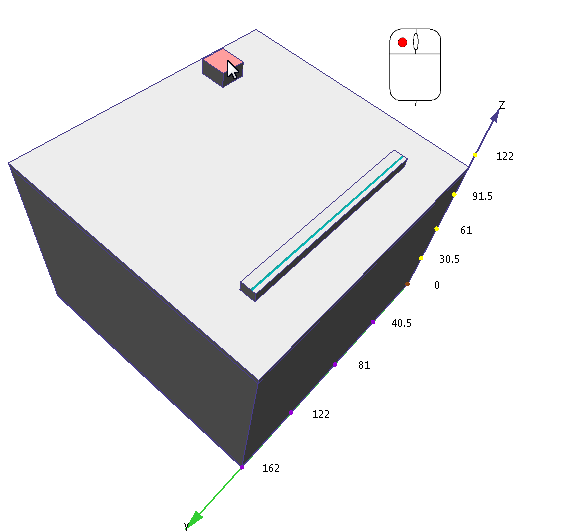

1. Left click on the return surface.

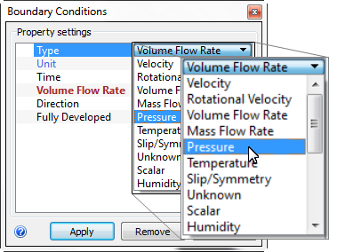

2. Click Edit from the Boundary Conditions context panel:
3. On the Type row, select Pressure.

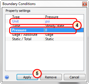

4. Leave the Unit as Psi and the Pressure value = 0.
5. Click Apply.
Note: This defines a static gage pressure of 0 psi, which simulates the outlet to the return duct.

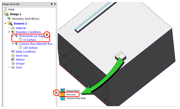

6. To verify that the boundary condition is correctly applied to the return, check the Design Study Bar and the colored stripe on the return surface:
  1. On the Design Study bar, the Pressure condition should be listed with a value of 0 psi.
  2. There should be a colored stripe on the return face that corresponds to the legend.
