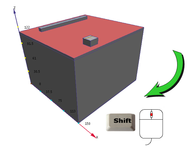

Note: We need to assign the boundary condition to nine exterior surfaces of the office.

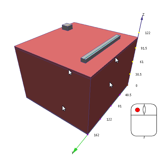

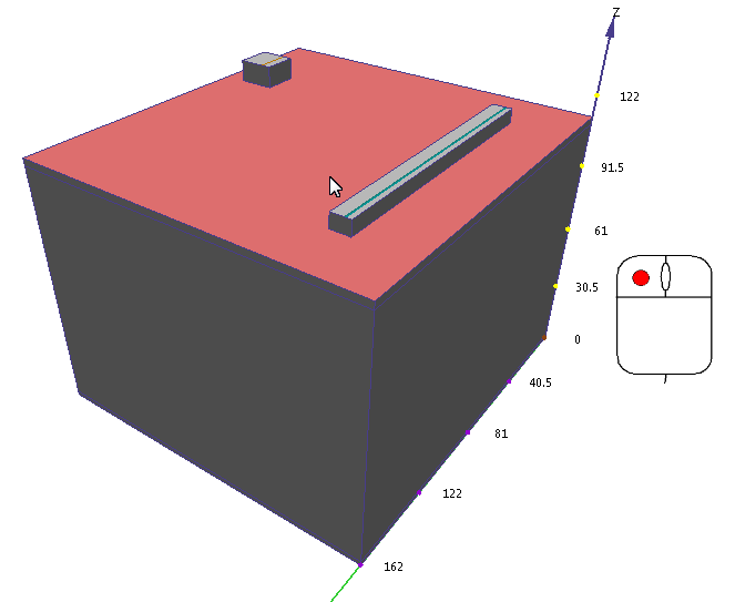

1. Select the roof surface.

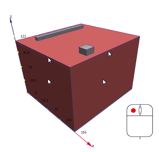

2. Select the wall surfaces (8 in all). You will need to rotate the model to access the surfaces on the other side:
Note: You should have nine surfaces selected.

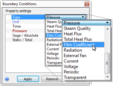

3. Click Edit from the Boundary Conditions context panel:

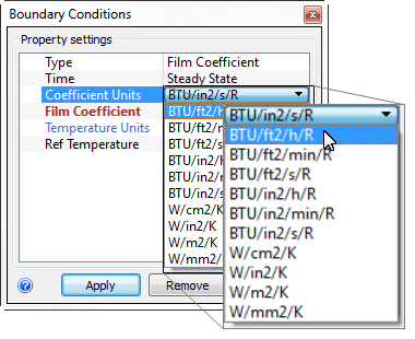

4. On the Type row, select Film Coefficient.
Note: You'll have to scroll down near the bottom of the list...
Note: This is the equivalent of a U-value.
5. On the Unit row, select BTU/ft2/h/R.

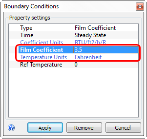

6. On the Film Coefficient row, enter 3.5, and verify the Temperature Units are Fahrenheit.

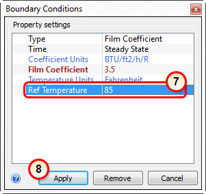

7. On the Ref Temperature row, enter 85.
8. Click Apply.

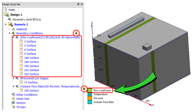

9. To verify that the film coefficient boundary condition is correctly applied to the exterior surfaces, check the Design Study Bar and the colored stripe on the surfaces:
  1. On the Design Study bar, the Film Coefficient condition should be listed with values of 3.5 BTU/ft2/h/R and 85 Fahrenheit.
  2. There should be a colored stripe on the exterior surfaces that corresponds to the legend.
