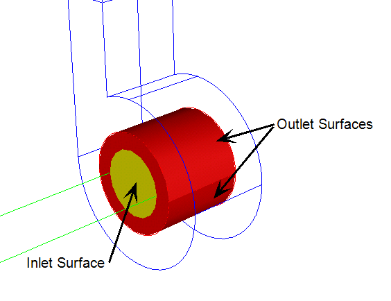

  5. To specify the axis of rotation, open the pop-out dialog on the Axis of Rotation line, and select either the Global X, Y, or Z axes. To graphically set the direction, click the Select Surface button, and select a surface. The axis will be normal to the selected surface.
  6. Select the inlet and outlet faces of the blower by opening the pop-out, clicking the Select Surface button, and selecting the surface from the blower device. This must be done for both the inlet and the outlet.
The inlet is typically the axial surface. Care should be taken when constructing the geometry that the inlet surface does not touch the outlet surface.
Alternatively, the device may be an annulus, like a squirrel cage. In this case, the inlet would be the interior annular surfaces, and the outlet would be the exterior cylindrical surfaces.
  1. Click Apply.
Parts assigned a centrifugal blower material should not be extrusion meshed. The Solver does not support centrifugal blowers with extruded elements.
Example showing assignment of a Centrifugal Pump/Blower material
