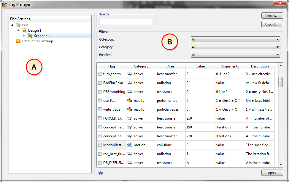

The Flag Manager dialog contains two primary panes:
  1. The Flag Settings pane is on the left. This shows which flags are selected as Default flags and which are active in the scenario.
  2. The Flag List pane is on the right. This is the complete list of flags.
