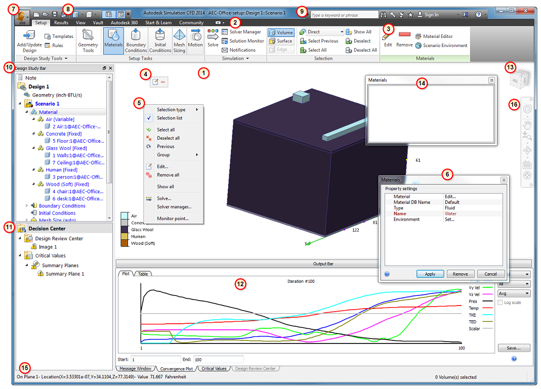

This is the default configuration of the Autodesk Simulation CFD User Interface:

User Interface Components
1. Graphics window
The Graphics window displays the model geometry, and contains several controls for interacting directly with the model. Navigate, select, and control entity visibility within the Graphics window.
These topics describe the specifics of interacting with the model:
2. Ribbon
Use the controls in the Ribbon for all stages of the simulation. The Ribbon is organized into tabs. Each tab is divided into panels. The commands on each panel are functionally related.
For more about the Ribbon...
3. Context Panels
The primary task items in the Setup and Results tabs have an associated Context Panel that appears to the right of the ribbon. These panels update based on the active task, and provide easy access to commonly used controls associated with the task. Additionally, the active context panel is visible when either the View or Get Started tab is selected to provide continuous access to these controls.
For more about Context Panels...
4. Context Toolbars
Context toolbars provide convenient access to frequently-used functions specific to the current task. To open a context toolbar, click the left mouse button in the Graphics window.
For more about Context Toolbars...
5. Right-Click Menus
The right-click menus contain commonly used controls that are contextual to the current task. They provide convenient access to commands while allowing focus to be maintained directly on the model.
For more about the Right-Click menus...
6. Quick Edit Dialogs
Quick edit dialogs are the primary tool for specifying parameters and values for model set up and result extraction. Every task has a unique quick edit dialog that contains fields for task-specific settings. They are an essential workflow element of Autodesk Simulation CFD.
For more about Quick Edit Dialogs...
7. Application Menu
Use the Application Menu to manage files, set preferences, and to access recently saved design studies. To open the Application Menu, click the large icon in the top left corner.
For more about the Application Menu...
8. Quick Access Toolbar
The Quick Access toolbar contains several often-accessed controls such as file commands and appearance controls. The toolbar can be readily customized to suit personal preferences.
For more about the Quick Access Toolbar...
9. InfoCenter
The InfoCenter is your connection to many Autodesk® resources for information and news.
Use the InfoCenter to:
For more about the Infocenter...
10. Design Study Bar
The Design Study Bar is a fully interactive tree-based tool for defining and managing all aspects of the Autodesk Simulation CFD process. The Design Study Bar follows a hierarchical structure that organizes the simulation process into three fundamental levels--Design Study, Design, and Scenario.
For more about the Design Study Bar...
11. Decision Center
The Decision Center is a simple yet powerful environment for comparing design alternatives. Use it to identify the design that satisfies your design objectives. The Decision Center is a key part of the results visualization process.
For more about the Decision Center...
12. Output Bar
The Output bar is the primary communication platform of Autodesk Simulation CFD. Status messages (and errors) are written to the Message window during several critical stages of the simulation process, including the following:
In addition to the Message Window, the Output bar contains tabs for the following actions:
For more about the Output Bar...
13. ViewCube
The Autodesk® ViewCube® navigation tool is a convenient, highly functional way to navigate your model and to adjust the viewpoint. You can use the ViewCube to quickly orient in any of 26 pre-set orientations, rotate the model about the Cartesian axes, and reset the model to its default orientation.
For more about the ViewCube...
14. Selection List
L'elenco di selezione contiene gli elementi selezionati nelle operazioni di impostazione. Si tratta di una funzione utile per individuare gli elementi selezionati.
Nelle operazioni risultati Piani e Superfici ISO, l'elenco di selezione contiene rispettivamente l'elenco dei piani o delle superfici ISO esistenti. Nelle operazioni Calcolatore parete, Parti e Risultati punti, utilizzare l'elenco di selezione per interagire con i controlli dell'operazione corrente.
Per controllare la visualizzazione dell'elenco di selezione, spuntare il pulsante di commutazione della barra degli strumenti Accesso rapido:
For more about the Selection List...
15. Status Bar
The Status bar displays values from probing results on surfaces and results planes.
For more about Probing...
16. Navigation Bar
The navigation toolbar is a collection of several tools for controlling model orientation and the view. It floats over and along one side of the graphics window. To activate a navigation action, click a button on the bar. Some of the buttons have additional tools in a sub-menu. To access these, click the small arrow below the button.
For more about the Navigation Bar...
