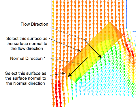

Not aligned with a Cartesian direction
To align the flow with a selected surface, open the pop-out dialog, and click the Select Surface button.

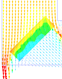

Resistance values for the normal directions specified on the Resistance Material Editor will be used by the Solver. The following image shows flow passing through a resistance object that is inclined at an angle to the flow. In this example, the Flow and Normal Direction 1 resistances were set to the same value. Obviously, the values can be different if desired:
The flow is turned slightly, but is not completely realigned to be normal to the resistance object.
To force the flow to be normal to a resistance (to produce a “vent” resistance), set the Normal Direction resistances to be at least three orders of magnitude greater than the Through Flow K. This causes the flow to turn so that its direction is normal to the resistance object.

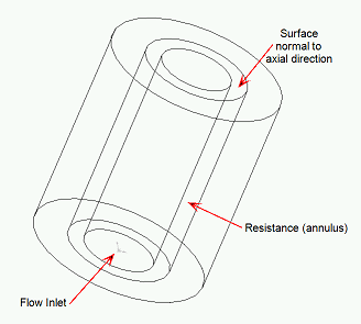

Through a Cylindrically Shaped Region
Use Radial for the Flow Direction to simulate a cylindrically-shaped resistance. The other two directions will automatically be set to Axial and Tangential.
Specify the direction of Normal Dir 1 to set the direction of this component. This is required for correct calculation of the orientation of the material object.
In Simulation CFD 2014, a new formulation was introduced for computing flow through cylindrically shaped regions. This method replaces a method that less accurately predicted pressure drop, particularly at low K values. This new method is enabled by default. To resort to the older method, change the value of the no_difu_tensors flag to 1 in the Flag Manager.
Another application for the Radial flow direction resistance is for a bank of resistive cylinders over which the flow must pass. In this case, the flow direction is again Radial, and an axial direction (select a surface normal to the axis of the cylinder) must be selected:
Example showing assignment of a cylindrical distributed resistance region
