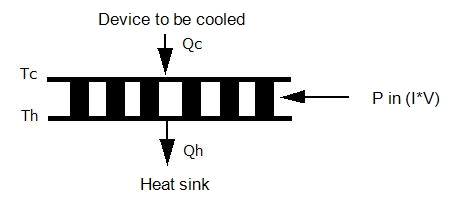

A simple schematic of a TEC device is shown:
In this diagram, the TEC device is used as a cooling device.
