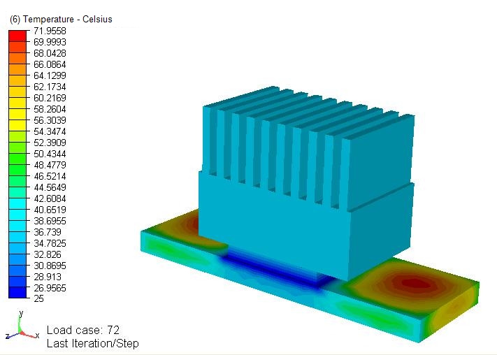

Results Extraction and Visualization
The physical performance of the TEC device within the assembly is best visualized by plotting temperature:

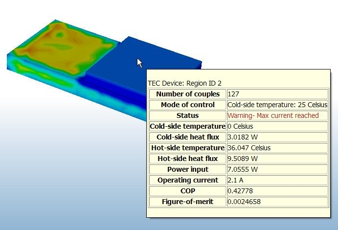

In the case shown above, heat is moved from the chip to the heat sink, and the sensing surface of the TEC device is maintained at 25 C. By hovering the mouse above the TEC device, a pop-up window will appear, showing a collection of data:
This data is also saved in the Component Thermal Summary file, accessible from Review_Component Thermal Summary in the main menu.
The output quantities are:
- Number of Couples
- Control Mode
- Status (Normal if operating limits are not exceeded. Otherwise, the status indicates if the limits of the device were exceeded. This indicates that the device would not be able to satisfy the desired target temperature within the system.)
- Cold side temperature
- Cold Side heat transfer
- Hot Side temperature
- Hot Side heat transfer
- Electric power consumption
- Operating Current
- Coefficient of Performance (Qc / Pin)
- Figure of Merit
