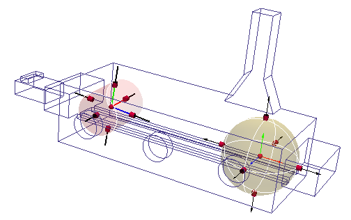

Locally refining the mesh is not difficult if there are geometric features within the high-gradient flow. Simply refine the mesh on the volumes or surfaces. If there is no geometry in a particular region, create a mesh refinement region. These regions provide control of the mesh distribution, without the need to create additional geometry in the CAD model.
Mesh Refinement Regions are available as rectangular, cylindrical, and spherical volumes, and can only be used to make the local mesh finer.
It is important to note that Refinement Regions are not real geometry, and cannot hold any other settings (such as materials or boundary conditions).
Refinement Regions are available for models from all CAD types and launch methods.

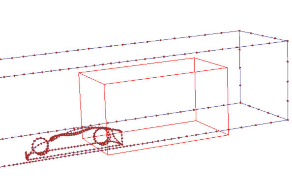

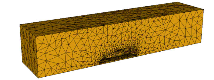

In this model, a wake downstream of the car requires a locally finer mesh. There is no geometry on which a finer distribution can be specified, so the resulting mesh is too coarse to accurately resolve the wake:

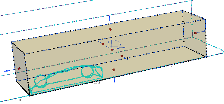

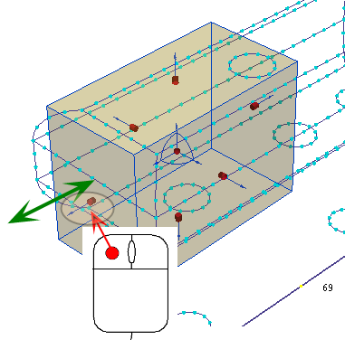

Select the shape (box, cylinder or sphere) from the Region Type line.

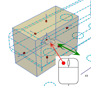

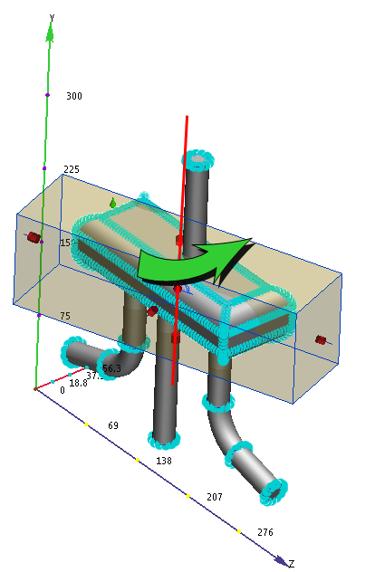

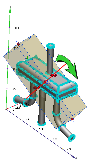

There are two ways to define size, position, and orientation: graphically or by keying in values. A good technique is to use the graphical tools first and then "fine tune" by keying-in values.
Note: It is a good idea to verify the location by rotating the model and looking at it from a couple of different directions. This will ensure that the region is placed as intended.

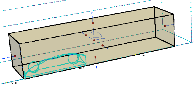

The mesh in a refinement region is based on the geometry enclosed within the region. To create a mesh with a single element size, click Uniform. Note that if the geometry has small features, and the region is large, the overall mesh count can be quite high.
To allow the mesh size to vary to produce a more efficient mesh, disable Uniform.
To define a varying mesh:
  1. Uncheck Uniform.
  2. Click Get local mesh size.
The resultant mesh grows from the smallest to the largest sizes within the region.

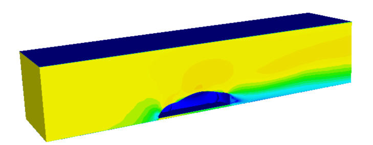

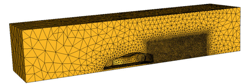

In this external aerodynamics simulation, a refinement region is created downstream of the car. The purpose is to better represent the flow in the highly turbulent wake region.

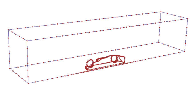

The mesh produced by the refinement region:
In the results, the separation downstream of the car is well defined. This concentration of mesh also helps to improve the accuracy of the drag on the car.
