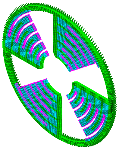

The Coulomb forces will be calculated only for specified surfaces of the model. To determine the force acting on a part due to an electrostatic field, designate the surface of the mating part. In this example, we want the force acting on the rotor. Therefore, we will specify the air surfaces that are in contact with the rotor.
For your convenience, all of the lines belonging to the rotor contact surfaces of the air have already been assigned a common surface number, specifically surface 5. This facilitates the Coulomb force calculation setup, since only one surface must be specified.
We will now visually verify the Coulomb force calculation surface and then set up the force calculation.
Home icon above the ViewCube for an isometric view of the model.
