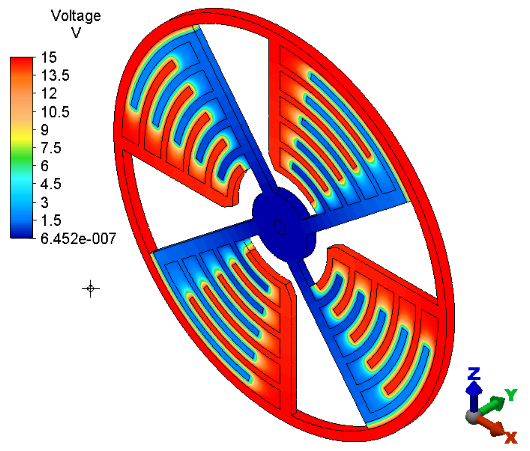

Voltage and Field Strength
Voltage to display the voltage distribution. Do not be concerned if your result for the minimum voltage (at the bottom of the legend) does not exactly match the image below. This number is essentially zero for all practical purposes.
