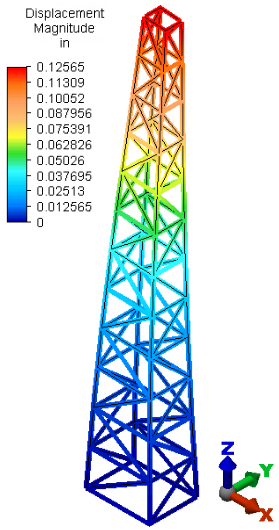

Run Simulation. The analysis proceeds and the model appears in the Results environment. By default, the displacement magnitude is presented initially.
The model displays the in-phase results of the first frequency. The maximum displacement magnitude is about 0.126 inches, as shown below.
