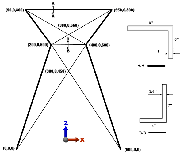

- The following properties and loads were already applied during the setup of the prerequisite stress analysis tutorial:
- Cross-sectional properties, as shown in the diagram below
- Beam material is Steel (AISI 4130) for all members
- Standard gravity load is applied in the -Z direction
- 5,000 lbf force in the -Z direction is applied to each of the two top corners
- Distributed load of 10 lbf/inch in the -Z direction is applied to the top horizontal beam
- Bottom two nodes are fully constrained
