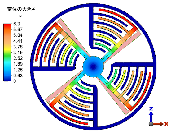

The analysis proceeds and the model displays in the Results environment. By default, the displacement magnitude is presented initially. We will display the actual deformed shape (absolute scale = 1). In addition, we will overlay the undisplaced shape as a transparency over the displaced results.
