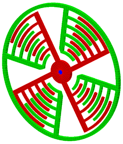

In this tutorial, we will determine the deflection of a radial comb motor due to the Coulomb forces generated by a voltage difference.
Features Illustrated:
- Brick elements
- Beam elements
- Activating and deactivating parts
- Rotational elastic boundary element
- Applying loads from a results file
- Static stress analysis and results
