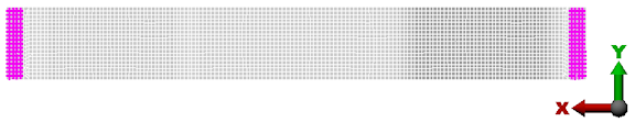

  2. With the  Selection Shape Point or Rectangle and  Selection Select Surfaces commands active, click the small rectangular support surface at the left end of the beam.
    • Holding down the Ctrl key, click the small rectangular support surface at the right end of the beam. With these two surfaces selected, the model should appear as shown in the following image.
