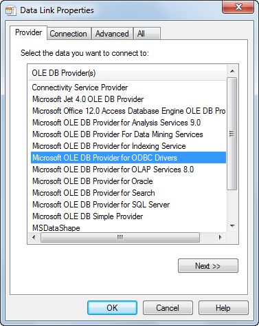

  5. Click the Provider tab.
  6. Select Microsoft OLE DB Provider for ODBC Drivers, and click Next.

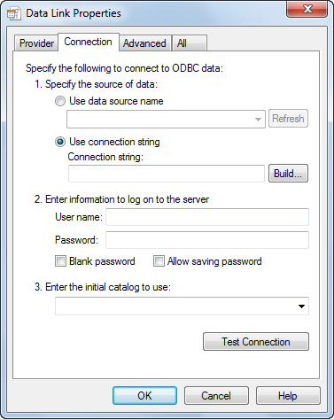

  7. In the Connection tab, click Use connection string.
  8. Click Build.

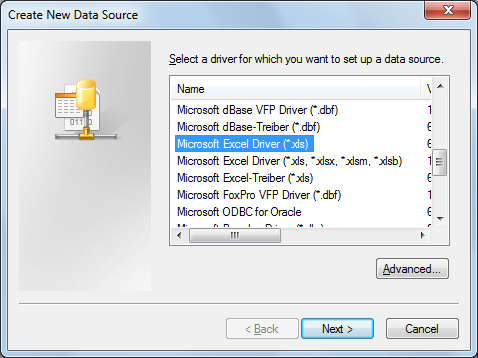

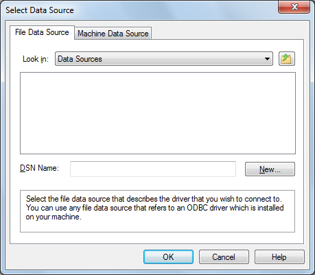

  9. Click New to build to a new DSN file.
  10. In the Create New Data Source dialog box, select the Microsoft Excel Driver (*.xls).
    Note: The other supported drivers here are Microsoft Access Driver (*.mdb) and Microsoft Text Driver (*.txt, *.csv). You can use these to create a link to an Access database, a plain ASCII text file, or a comma-separated file.
  11. Click Next.

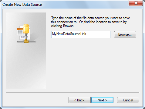

  12. Enter a name for the new DSN file, and click Next.
  13. Confirm that your data source settings are correct, and click Finish.

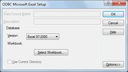

  14. In the ODBC Microsoft Excel Setup dialog box, select the version of Microsoft Excel that the DSN file should support.

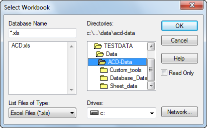

  15. Click Select Workbook.

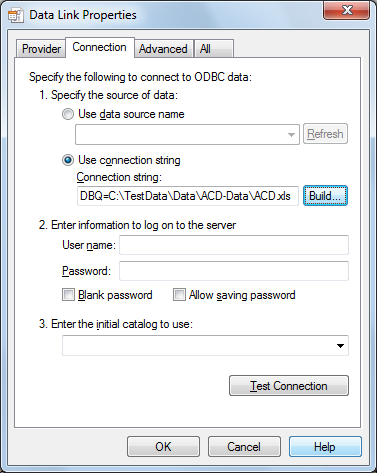

  16. Select an XLS file that should be used as your data source, and click OK three times until you are back in the Connection tab of the Data Link Properties dialog box.
    The Microsoft Excel file you have selected as your data source is displayed under Connection String.
  17. To verify that the connection to the data source is working correctly, click Test Connection.
  18. Enter a user name and optionally a password for the database connection.
  19. Under Enter the initial catalog to use, select the Excel file from the drop-down list.
