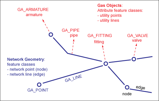

Gas Data Model Component Feature classes
Network geometry
Network geometry is stored in the GA_POINT (for nodes) and GA_LINE (for edges) feature classes. These feature classes store geometry only, not attributes. They are related to the gas features for attribute information.

Gas objects are stored in the GA_POINT.FID_ATTR (utility points) and GA_LINE.FID_ATTR (utility lines) attribute feature classes. These have a relation to the associated point or line geometry feature class.
