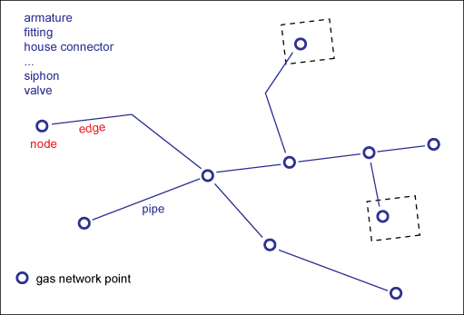

The Gas data model contains the following two topologies:
The node and edge geometry feature classes are stored in the Topology topic.
Gas network topology. Network points are connected with lines. Network points must not lie on a network line.
Achieving a Valid Network Topology
The topology requires that network points always lie at the start or end of a network line. A network point must never lie on a line. If you insert a network point on a network line, the line must be split at the insertion point. The consistency of the topology is maintained by feature rules.
If a network point is removed, the connecting lines must be merged.
