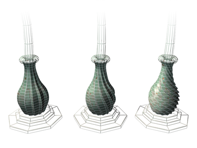

Links: Originalmodell
Mitte: Geringe Verdrehung
Rechts: Extreme Verdrehung
