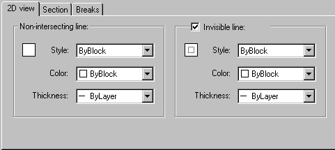

- 2D view - use the options on this tab to define style, color, and thickness parameters of a non-intersecting line and of an invisible line in 2D

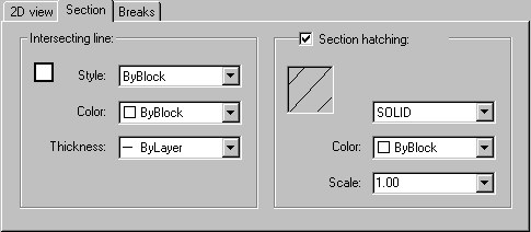

- Section - use the options on this tab to define parameters in section view
- Intersecting line - style, color, and thickness
- Section hatching - style, color, and scale

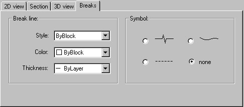

- Breaks - use the options on this tab to define style, color, and thickness parameters of break lines and to define symbol style.
