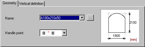

On the Geometry tab of the Door: definition dialog, you can define parameters of a door.
Specify geometry parameters:
- Name - the shape of the door is determined by the name you select. To create a new shape, click Browse (...), which opens the Door list dialog
- Handle point - (it is a point in an opening; the door opening in the wall is inserted in relation to this point); the door handle point may be positioned
- On the left
- In the middle
- On the right
