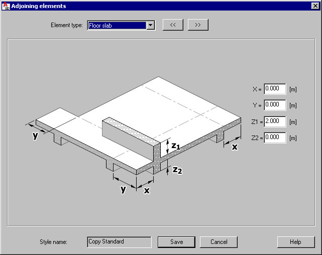

Adjoining elements
Use this dialog to define parameters for elements that adjoin the selected element type. These parameters determine the length of adjoining elements in a drawing.
To display the Adjoining elements dialog:
  1. On the Drawing template manager dialog, for Drawing components, select Adjoining Elements
  2. Click New or Modify.
For Style name, enter a name for the component style, and click Save (this is only available when creating a style, not when modifying an existing style).

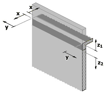

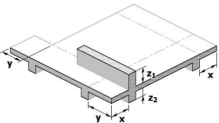

In the Adjoining elements dialog, specify dimensions that form the surroundings of a selected element type.
For individual element types, you can choose the following parameters:
Element Type
Preview
Parameters

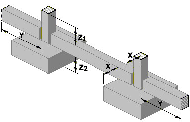

Beam
X, Y, Z1, Z2
Ground beam
X, Y, Z1, Z2
Column
X, Y, Z1, Z2

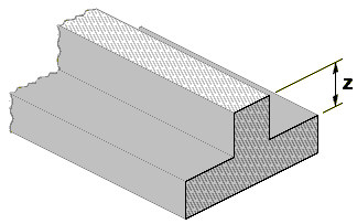

Spread footing
Z

Continuous footing
Z
Floor slab
X, Y, Z1, Z2

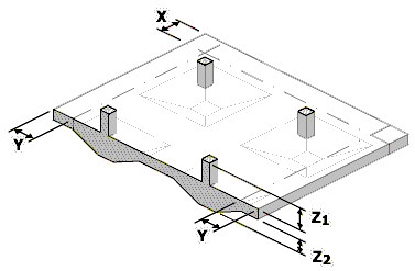

Raft foundation
X, Y, Z1, Z2

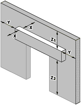

Lintel
X, Y, Z1, Z2

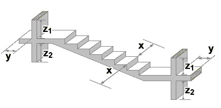

Stairs
X, Y, Z1, Z2
