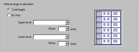

Definition tab for modification of the vertical section and the elevation view
The vertical section through a structure and the structure elevation view can be made for:
Whole structure height
Selected story (selected stories) of a building
For this case, define the following parameters:
Upper level (upper story with an offset, if needed); the upper limit of the section
Lower level (lower story with an offset, if needed); the lower limit of the section.
The following sign convention for offset values has been adopted (it refers both to the lower and upper levels of a story):

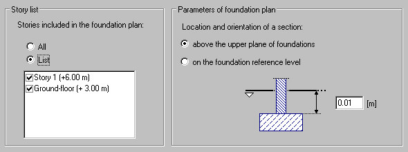

Definition tab for modification of a foundation plan
A foundation plan can be made for:
After you select stories to be included in the foundation plan, it is necessary to update the foundation plan.
