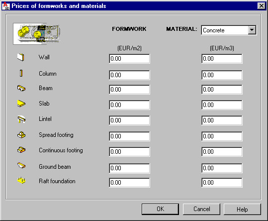

Use the options on the Prices of formworks and materials dialog to select prices of formworks for RC structure elements and prices of materials (such as concrete, steel, and timber). These prices will be used in tables generated by the software.
To access the dialog:
- Click Formwork Drawings menu > Job Preferences
- On the left of the Job Preferences dialog, select Databases, and then under Databases, select Materials
- Click Prices.
You can determine the prices of:
- Formworks of individual component elements of RC structures (in EUR per square meter)
- Materials (brick, concrete, steel, and timber) for individual component elements of a structure (in EUR per cubic meter).
