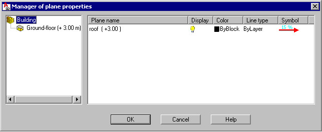

Using this option, you can view or edit parameters of intermediate or inclined planes defined in a structure model.
To begin editing plane parameters, open the Manager of plane properties dialog from:
- Menu: Formwork Drawings > Display > Show planes
- Ribbon: ASD - Model > Display > Show planes
- Toolbar: Define > Show planes
- Command line: RBCX_EDIT_PLANES.
View or edit parameters for defined planes:
- Plane name (with additional information regarding the level of plane definition)
- Display - click the light bulb symbol to change the plane display
- Color of plane on the screen
- Line type used for plane display
- Inclination symbol - None, arrow, or arrow with the inclination value.
For each of the parameters, you can right-click to access additional options:
