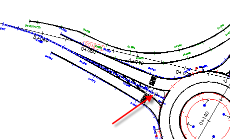

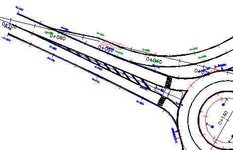

To edit approach road geometry
Design panel
panel
The approach road is extended, the exit radius has increased, and linework for the islands and the pavement markings have been updated.

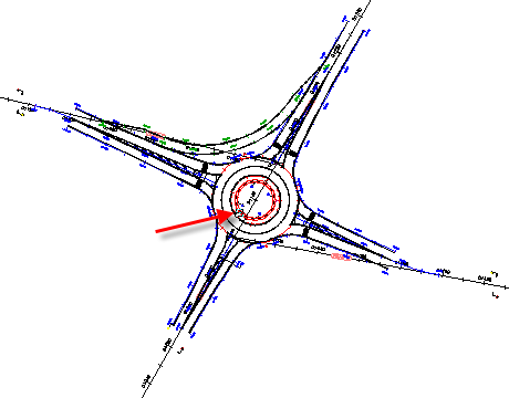

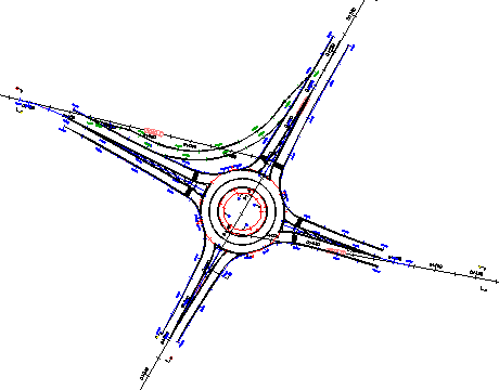

To edit roundabout location
panel
Chainage 0+130 is not labeled, but the location is shown in the following image.
The roundabout alignments and pavement markings are recreated around the new center point.

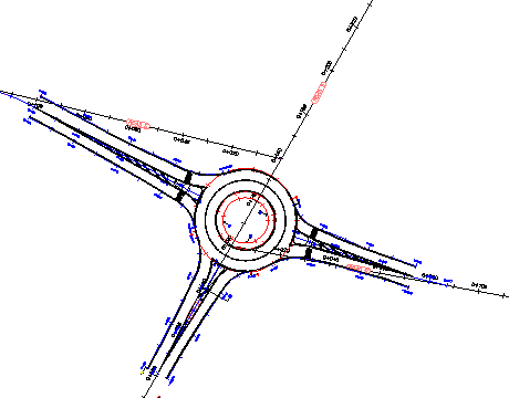

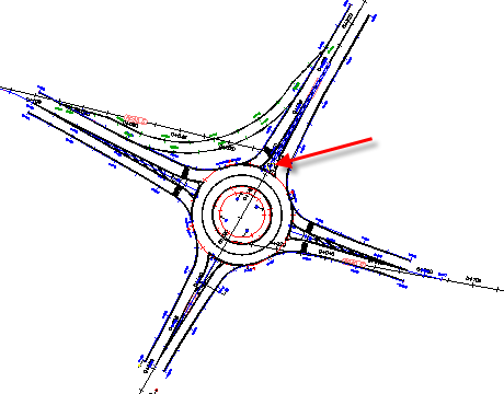

To delete roundabout components
panel
Both the approach road and the turn slip lane are deleted. The turn slip lane was deleted because its geometry was dependent upon the geometry of the approach roads to which it was attached.
