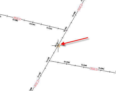

  3. To specify the roundabout center point, in the drawing, on the ROAD D alignment, click chainage 0+140.

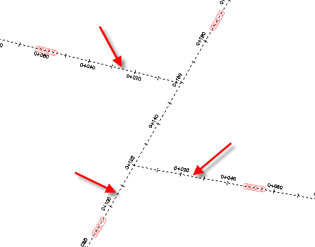

  4. To specify the approach roads, click Roads C, D, and E as shown. Press Enter.

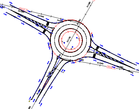

  1. Click Finish.
    The roundabout is displayed in the drawing. Notice that the centerline alignments for the approach roads at Road E and Road C were created with a curve that provides a smooth transition from the parent alignment to the approach road.
    Notice that while you selected Road D as an approach road, only one end of it was created as an approach road. When an alignment passes through a roundabout center point, only the alignment end that you click is added as an approach road. You will learn how to add the other end as a separate approach road in Exercise 2: Adding an Approach Road to a Roundabout.

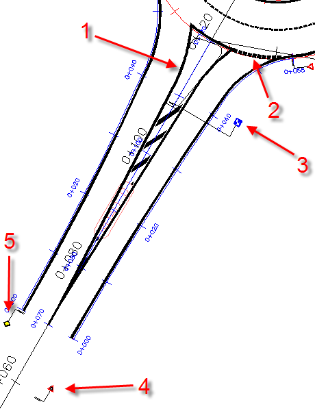

  2. Zoom in to the South To North Approach road.
    When you compare this approach road to the others, you see that, per the parameters you specified but did not apply to all the approach roads, these elements, which are shown in the following illustration, are different:
    1. The splitter island is not divided.
    2. The yield line is dashed.
    3. The J5 (keep right) sign has a leader line that extends outside the roundabout geometry.
    4. The A25 (approaching roundabout) sign is 60 meters from the circulatory road edge.
    5. The AB6 (exiting roundabout) sign is 50 meters from the circulatory road edge.
