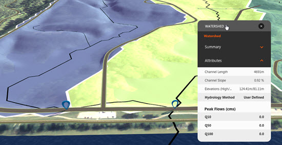

Identify and analyse all watersheds intersecting a selected design road or identify watersheds from a single low point in the terrain.
- A single analysis may identify multiple watersheds. Each watershed is a selectable feature. Click inside one to display its asset card.
- Drainage Design displays watershed extents and ditch locations and marks where ditchs cross design roads with a blue balloon pin.
- Analysis uses the existing ground surface prior to placement and grading of a design road. Analysis aims to identify existing drainage patterns prior to road placement and design.
