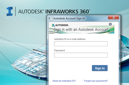

If you have InfraWorks 360 installed, you start the application then sign-in using your Autodesk 360 account credentials.
InfraWorks 360 opens to InfraWorks Home.

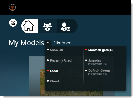

- The
icon in the top left corner of the Utility Bar indicates that you're not signed-in to InfraWorks 360
shows that you're signed-in. You must be signed in to InfraWorks 360 to view and download Cloud models, as well as to filter your models by Group (see below).
