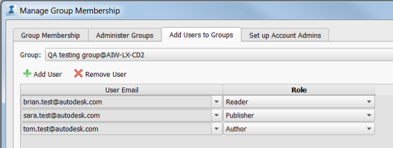

To add users to a group and assign roles
Admins use the Add Users to Groups tab in Manage Group Membership panel to add members to a design group and assign them Roles.
  1. On InfraWorks Home, click to display a horizontal menu.
  2. Click to open Manage Group Membership. Switch to the Add Users to Group tab.
  3. Select the correct Group from the pull-down menu.
  4. Click .
  5. Enter the name as a valid email address in User Email field.
  6. Assign a Role.
    The default role is Publisher. Use the pull-down menu to change the Role. You can not assign the Admin role to a member from this tab. Use Set up Account Admins.
  7. Click Done to send an email invitation to each new user added and a Notice on their InfraWorks Home.
    Users must accept the invitation to join the group.
