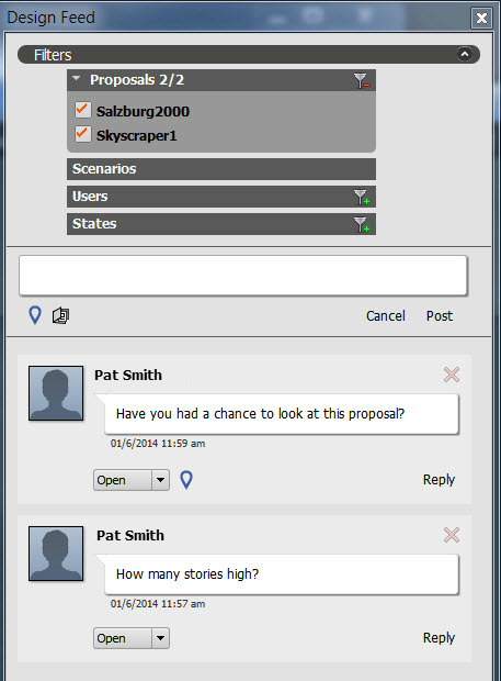

About Design Feed for commenting on models, proposals and scenarios
Discuss on-line models, proposals and scenarios using Design Feed. You can make notes to yourself or share them with others. Users or viewers with InfraWorks 360 the mobile app can reply to comments and add their own.
Open Design Feed by opening a model and clicking in the Utility Bar.
  • Filter by proposals, scenarios, users, or state of comments (open, resolved, closed, reopened).
  • Add a comment and post it.
  • Link a comment to a location in the model.
  • See a list of scenarios attached to model.
  • Reply to a comment.
  • View or change the status of a comment.
  • Go to the location associated with a comment.
  • Delete a comment or thread (if it's closed and you have thread-owner privileges.)
