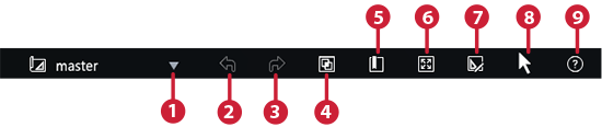

Tools that you will need across many phases of your work
  1. Switch active proposals.
  2. Undo.
  3. Redo.
  4. Control visibility, display and selectability of features with the Model Explorer.
  5. Bookmark locations.
  6. Display your model in full-screen mode.
  7. Switch to edit mode.
  8. Switch to selection mode.
  9. Get help.
