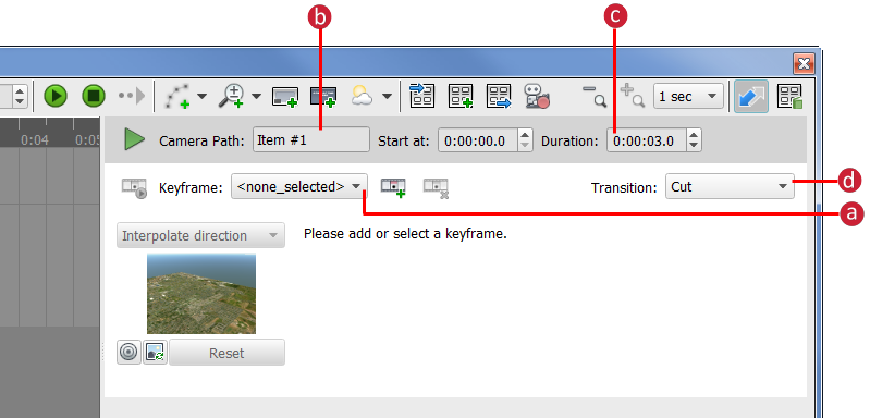

- Specify the following settings for your camera path:
a. Deselect the keyframe.
b. Specify a name for the camera path
c. Specify a duration for the camera path animation. You can also specify a start time (optional).
d. Specify a cut or fade transition for entering and exiting the camera path frame.
Note: If you specify Fade From Black or Fade From White, you'll be prompted with an additional field to specify the duration of the fade transition.

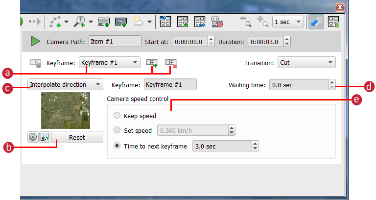

- Select a desired keyframe from the Keyframe list to specify its settings.
a. Select the desired keyframe. You can click
to create a new keyframe or click
to delete the selected keyframe.
b. Navigate in your model to the desired view for the selected keyframe then click Reset in the Storyboard Creator. This will set the current model view for the selected keyframe.
c. Specify the camera behaviour for the selected keyframe.
- Look Along Path — Keeps the camera facing straight ahead.
- Interpolate Direction — Smooths out the transitions between different camera angles.
- Interpolate Focus Point — Remains focused on a central point as the camera moves.
d. Specify the Waiting Time in seconds.
e. In the Camera Speed Control group, specify how the camera is controlled between shots (keyframes) in the sequence. For details, see "Advanced Tips," below.
