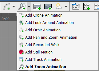

Add an animated camera path or a motion animation to a storyboard and specify desired animation types, as well as settings such as frame transition styles.
— Crane The camera moves up and away from the original position, or down and towards it.
— Look Around The camera remains in a fixed position and moves to the rotation angles you specify to rotate the view left or right and to angle up or down.
— Orbit The camera rotates around the focal point. Imagine the camera moving on an imaginary sphere around the feature in the centre of the screen, which remains fixed.
— Pan and Zoom The camera pans simultaneously to zooming. The effect is a zooming motion that doesn't remain centred on the same point. To see the panning effect, you must set at least one of the Distance values to a fairly large value (several kilometres). The distances displace the zoom target point (which would otherwise be the feature in the centre of the screen).
— Recorded Walk The camera jumps directly to the shot and then plays a recording that you make. This lets you display specific features from specific angles, rather than panning or zooming in general.
— Still Motion The camera doesn't move during the shot, although it may move during the transition into the shot. This is similar to a slideshow.
— Track The camera moves to the left or right of the original position.
— Zoom The camera moves in or out from the original position.
