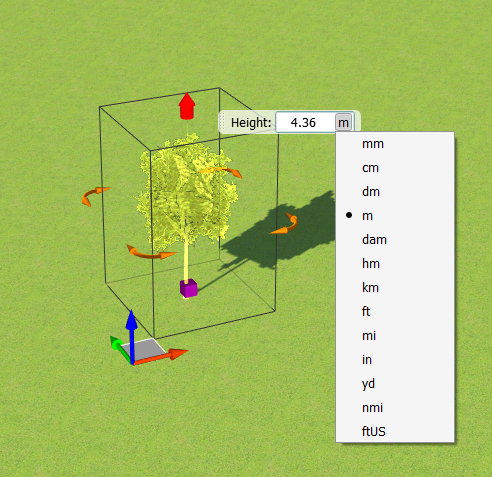

Available modification methods depend on the type of features you select.
To modify a feature, select it or create a selection set.
Gizmos
Control Points
Attributes
