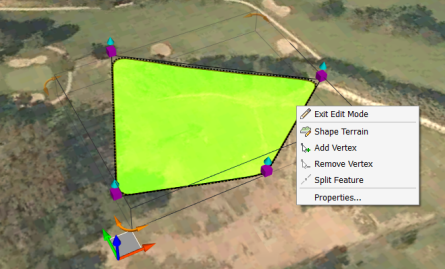

  1. Sketch a coverage.
  2. Click in the Utility Bar to enter Edit Mode.
  3. Right-click on the coverage area to open the context menu and select Shape Terrain.

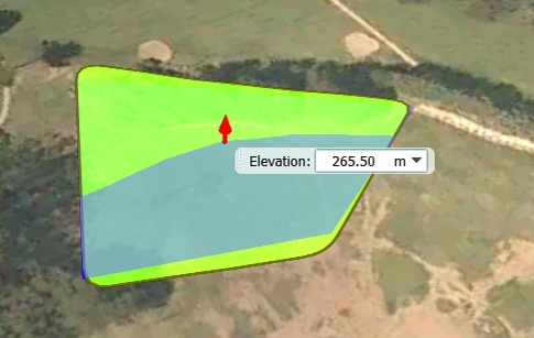

  4. Drag the vertical arrow up or down to modify the coverage to the desired level. Alternately, you can enter the desired level in the level dialogue box and press Enter to update your coverage.
    All vertexes on the coverage boundary are set to this value.
