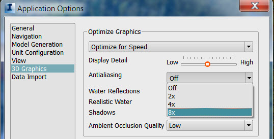

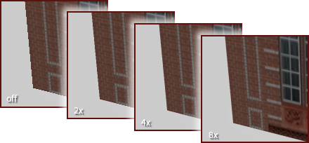

You can turn antialiasing on or off, as well as increase or decrease the level of antialiasing between 2x, 4x, or 8x.
Aliasing is the staircase effect that occurs when square or rectangular pixels are used to draw diagonal or curved edges on raster displays. Antialiasing improves image quality by sampling adjacent pixels to smooth those edges.
to open Application Options window.
