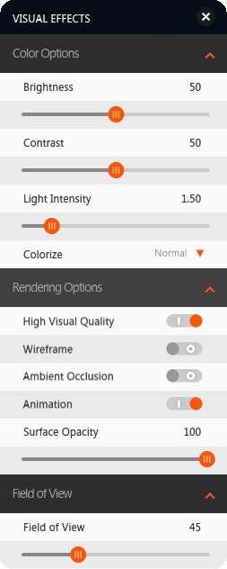

Use the Visual Effects
panel to control a range of visual and lighting effects. Use together with Sun, Wind and Cloud settings
to customise your model's appearance.
Click
to display the Visual Effects panel.
| Visual Effects Panel | Experiment with these settings to see the differences each one makes |
| Effect | Definition | Example |
| Normal | Without any effects applied, a styled building looks like this. |
| Ambient Occlusion |
When ambient occlusion is on, surrounding features throw soft shadows on their neighboring features. When you turn ambient occlusion off, images reflect the angle of the sun, without taking into account surrounding features. You can set ambient occlusion to high, low, medium, or off. Enabling ambient occlusion can affect programme performance depending on your graphic card and the application window size. |
| Wireframe |
Wireframe reduces features to three-dimensional skeletons, displaying only lines and vertexes. |
| Field of View |
A wide FOV setting zooms out from the current view and flattens features, much like a wide-angle lens on a camera. Features appear smaller and further away than they actually are. |
| Surface Opacity | Make the model surface transparent to see features below the terrain. |
| Brightness |
Brightness is the range between the darkest and lightest colours in the image. High brightness reduces the amount of black in colours, so the image looks like an overexposed photograph. The example on the left shows high brightness. Low brightness increases the amount of black in colours, so the image looks like a photograph taken with insufficient light. The example on the right shows low brightness. |
| Contrast |
When you increase the contrast in your model, lighter tones get lighter and darker tones get darker. This can produce more definition between areas of differing values, which gives the image more depth. The example on the left shows high contrast. When you decrease the contrast in your model, the distinction between light and dark is decreased. This produces a lighter, flatter look. The example on the right shows low contrast. |
| Sepia and Greyscale |
Sepia displays the model in monochromatic shades of brown. Grayscale displays the model in monochromatic shades of grey. |
