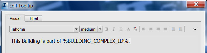

You can format the visual appearance of tooltips using familiar visual formatting options or HTML tags.
If you include a property in a tooltip, all individual features that contain a value for that property will display that value. For example, a feature class tooltip for buildings tooltips could include the BUILDING_COMPLEX_ID property.
Each building would display a tooltip that includes its corresponding BUILDING_COMPLEX_ID value. If a building doesn't contain a value for BUILDING_COMPLEX_ID, its tooltip will be blank.
