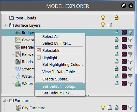

  1. Click in the Utility Bar to display the Model Explorer.
  2. In the Model Explorer, right-click the row for the feature class whose tooltip you're creating.
    For example, right-click Roads.
  3. Click Select All to apply the Tooltip to all objects in the feature class.
  4. Right-click the feature class row again and Click Set Default Tooltip to open the Edit Tooltip window.
  5. Enter Tooltip content.
