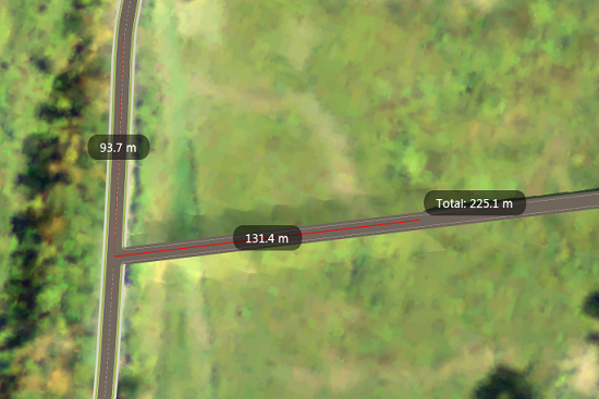

Use the Path Distance tool to measure the horizontal and/or vertical distance along a polyline.
. The distance between each two points appears on the line between the points. Each one is labeled separately.
The total distance is displayed in a separate label.
The tool is still active and you can measure a different polyline path.

The resulting distances are displayed as dimensions. A label shows distance values for each measurement and for the total distance, using the current unit of measurement. If necessary, you can use the application options dialogue to change unit of measurement.
