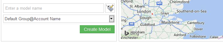

- Select an area of interest on the map.
Note: The Model Builder supports model areas up to 200 square kilometres, or lengths up to 200 kilometres in latitude or longitude.
- Enter a name for the model and select the InfraWorks 360 group for the new model.
Note: Optionally, click
to enter a description for the model.
- Click Create Model.
InfraWorks 360 sends an email notification to the email address associated with your Autodesk 360 account when Model Builder has finished loading the model.
