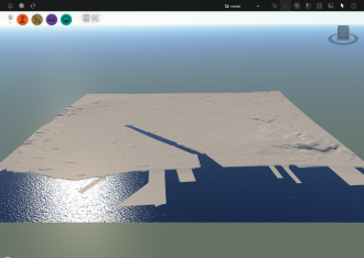

Terrain (Level) |
Raster-based data (grids) or vector-based data (TIN or contour files) are supported for terrain data. |
Terrain and Water areas |
Water areas are represented by coverages and draped on the terrain.

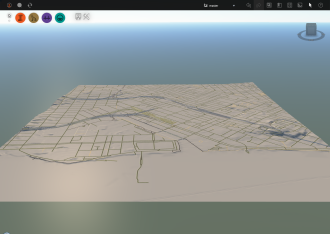

Terrain and Transportation Data (Roads and Railways) |
Roads and railways are draped on the terrain.

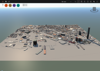

Terrain and Building Data |
Buildings are draped on the terrain.

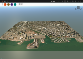

Terrain, Water Areas, Aerial Imagery, Transportation Data, Building Data and 3D models (City Furniture, Trees and so forth.) |
