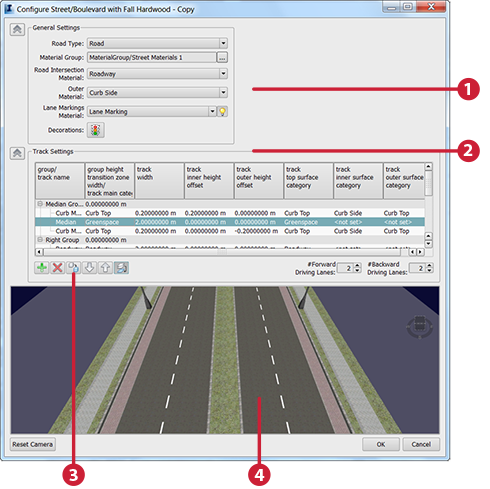

  4. Double-click the new copy of the style to open the Style Editor window, or select the style and click .
    1. General settings
    2. Track settings
    3. Track operations
    4. Preview area
  5. Under General Settings, specify the following:
    Setting Description
    Road Type
    Select Road, Bridge, or Tunnel.
    Material Group
    The collection of materials and associated categories that map a material to the different parts of a road style. You can define each component of the material group separately, from within its catalogue. See Edit Styles.
    Road Intersection Material
    Specify the category whose material will be used for areas where road segments cross.
    When road segments share a crossing region but use different road styles, the road segment with the highest Importance property determines the material for the crossing region. To set this property, display the Propertiespalette for the road segment. Under Transportation, enter a high value for Importance.
    Lane Markings Material
    Specify a category whose material will be used for lane markings. No lane markings are generated for intersection regions. Turn lane markings on or off using .
    Decorations
    Click and specify any decorations for this style.
  6. Use the Track Settings section to define the road elements.
    The rows in the Track Settings table represent elements of the road; the columns represent the attributes of each track. The rows are organised by groups: the right side of the road and the central reserve strip.
    By default, the left side of the road mirrors the right side.
    • To create an asymmetric road, click (below the table). This adds a new group called Left Group. The new group appears at the top of the table.
    • To add, remove, copy, or re-order tracks, use the buttons below the table.
    • Double-click a table cell to edit it. Some cells contain a drop-down menu after you click in them.
      Column Description
      Group/Track Name An identifier for this track and its group. The group is either Central Reserve, Right, or Left (if you added Left); the track is a component of one of those groups.
      Group Height Transition Zone Width/Track Main Category The Group Height Transition Zone Width applies to the group.
      The Track Main Category is the basic material type for the corresponding road element in the Track Name column.
      Options in the list are determined by the Material Group you selected in the General Settings area.
      Track Width Enter a width for the corresponding road element in the Track Name column. The default unit of measurement is used.
      Track Inner Height Offset Enter the beginning height of the corresponding road element in the Track Name column, relative to the preceding track in the column.
      The initial height is based on the centre line of the road surface. This allows you to define the road profile as a "stairway" curve for modelling ditches and kerbs.
      Track Outer Height Offset Enter the ending height of the corresponding road element in the Track Name column, relative to the next track in the column.
      Track Top Surface Category Select the material for the top surface of the road. Options in the list are determined by the Default Material Group you selected in the General Settings area.
      Track Inner Surface Category Select the material for the vertical geometry that is created if the inner offset height value is greater or less than zero.
      Track Outer Surface Category Select the material for the vertical geometry that is created if the outer offset height value is greater or less than zero.
      Note: If you specify a material type that is not mapped to any material in the Material Group, the default material for that Material Group is used instead. This material is specified in the Material Group style. See Edit Styles
