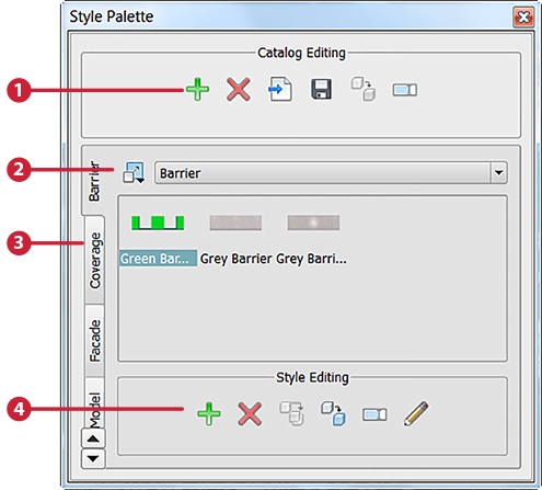

Use the Style Palette to manage style catalogues and apply styles.
Drag a style from the preview area onto a feature to apply that style. For more information, see Override Style Rules.
The elements in the Style Palette are:
| Icon | Name | Description |
Add New Style Catalogue |
Creates a style catalog that is stored in a XML file in a location you specify. It's added to the Style Palette and becomes the current style catalogue. |
Delete Selected Style Catalogue |
Removes the current style catalogue from the Style Palette. You can re-import it if you need it again. |
Import Style Catalogue From File |
Imports a style catalogue from the XML file you specify. It's added to the Style Palette and becomes the current style catalogue. |
Copy Selected Style Catalogue |
Duplicates the current style catalogue. The copy is stored in a XML file in a location you specify. The copy becomes the current style catalogue. |
Rename Selected Style Catalogue |
Lets you enter a new name for the current style catalogue. |
to change the size of the previews that display the contents of the catalogue. A slider lets you change the size dynamically. When you click a tab, the current style catalogue changes to the first available catalogue for that category.
Add New Style |
Creates a style within the current catalogue. A blank style entry appears in the preview area. Double-click it to specify the style. For more information, see To add a material style. |
Delete Selected Style |
Removes the selected style from the current catalogue. |
Copy Style To Another Catalogue |
Copies the selected style to a catalogue within the current category. For example, use this option to copy a barrier style from one barrier catalogue to another. |
Make a Local Copy |
Copies the selected style to the current catalogue. Use this option to create a new style that is similar to the one you're copying. The copy appears in the preview area. Double-click it to make your changes. |
Rename Selected Style |
Lets you enter a new name for the selected style. |
Edit Selected Style |
Opens the Style Editor, where you can change the properties of the selected style. For more information, see Edit Styles. |
