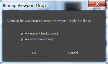

Bitmap Drag and Drop: You can drag the thumbnails that represent bitmap files to any bitmap or map slot in the interface or onto any object in a viewport. You can also drag the thumbnails into the viewport background. When you drag a bitmap onto an object, 3ds Max creates a new standard material with the bitmap as the diffuse map and assigns the material to that object.

To drag a bitmap onto an object in a viewport:
3ds Max opens the Bitmap Viewport Drop dialog:

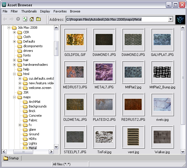

When you first start the Asset Browser, a window appears displaying the home page that is installed locally on your computer system.
Each subsequent time that you start the Asset Browser, it displays what was displayed last in the previous Asset Browser session.
The Asset Browser window contains:
At the bottom of the window, there is also a tabbed favorites bar (by default, it first contains a Startup button) and a status bar.

Turns the directory tree in the left pane on or off. The directory tree displays the available directories on your system. You can navigate and select the directories where you want to view images. When you select and enter a directory containing valid bitmaps, the Browser displays their thumbnails in the Thumbnail pane to the right. Right-clicking in the directory tree pane displays a menu allowing you to change directories, delete directories, and add a directory to your Favorites list.
Turns the Favorites bar on or off. The Favorites bar is located at the bottom of the Asset Browser window.
Turns the status bar on or off. The status bar is located at the bottom of the Asset Browser window.
Displays valid bitmaps and geometry files of a selected directory as thumbnails in the right pane.
