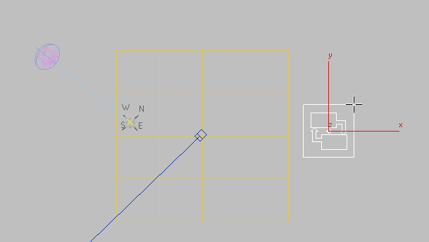

- On the
Create panel, activate
(Geometry). Open the Objects drop-down list, and choose Particle Systems.
- On the Object Type rollout, click PF Source to activate it. In the Top viewport, drag anywhere outside the plane to place the Particle Flow source icon.
The size and location of the source icon is not important, since the particles will be generated from the plane object.
- Right-click to end object creation.

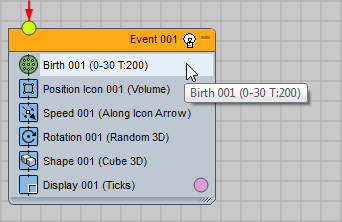

Initially, the system contains two events: the source that you just created, and a default Event 001.
- In Event 001, click the Birth 001 operator to highlight it.
On the right of Particle View, the Birth 001 rollout displays parameters that relate to particle creation. The Emit Start and Emit Stop spinners indicate that particle generation will start at frame 0 and end at frame 30. The Amount spinner indicates that 200 particles will be generated by the system.

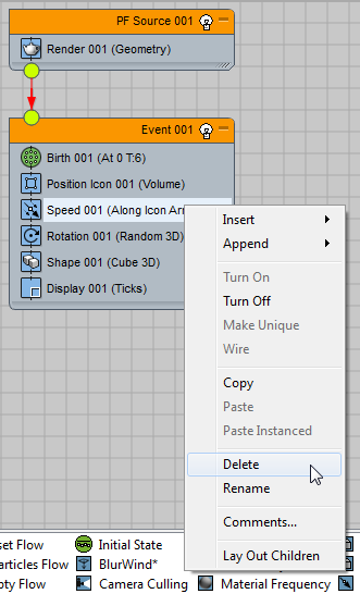

- In Particle View, click the Speed 001 operator to highlight it, then right-click and choose Delete, since you do not want the particle trees to move.
- Delete the Rotation 001 operator as well, since the orientation of the particles will be driven by the camera position.

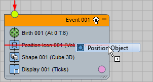

- The “depot” is the list of operators and tests that appears at the bottom of the Particle View window. Drag a Position Object operator from the depot and in Event 001, drop it directly over the Position Icon 001 operator.
3ds Max displays a red line to indicate you are replacing the original operator with the new one.

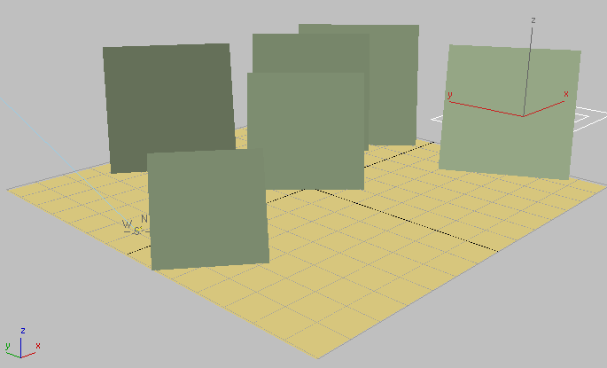

Before, particles were emitted from the particle source icon. Now, particles are emitted from the Plane01 object: You can see them scattered about the plane’s surface.
- Click the Display 001 operator to highlight it. On the Display 001 rollout, open the Type drop-down list, and choose Geometry.
It is now easier to visualize the particles, although soon you will be replacing these shapes with tree images.
- Click the Position Object 001 operator again and on the Parameters panel, scroll down to the Uniqueness group. Click New to change the positioning of the particles. Continue clicking the button until you get a grouping you like.

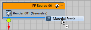

- From the depot, drag a Material Static operator to the PF Source 001 event. Drop it just below the Render 001 operator. A blue line indicates the point of insertion.
Note: You are defining the material at the PF Source 001 level because you want all the trees to share the same material throughout the particle life span. If you wanted to assign the trees different materials based on a specific particle event, you would have dragged the Material Static operator to the appropriate event box.

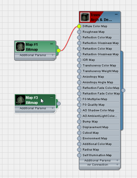

- Open the
Slate Material Editor.
- Drag an Arch & Design entry from the Material/Map Browser into the active View.
- Double-click the Arch & Design material node to display its parameters.
- Name the new material Trees.
- On the Templates rollout, open the drop-down list and choose Matte Finish.
With Matte Finish, the trees will not pick up any reflection from neighboring objects.
- Drag a Bitmap entry from the Browser into the active View.
3ds Max opens a file dialog. Navigate to
\sceneassets\images
and choose
elm_summer.tif.

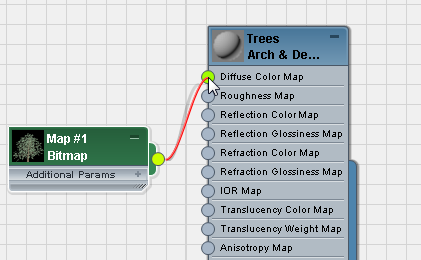

- Wire the new Bitmap node to the Diffuse Color Map socket of the Trees material.

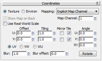

- On the Coordinates rollout, turn off Use Real-World Scale if it is on, and make sure Tiling is set to 1.0 for U and V.
This step ensures that the image area matches the size of the particle.

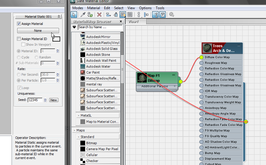

- Click the Trees material node to make it active, then on the Slate Material Editor toolbar, click
(Show Shaded Material In Viewport) to turn it on. (If you use a legacy viewport driver, this button's tooltip reads, "Show Standard Map In Viewport.")
- Move Particle View and the Slate Material Editor so you can see both windows. In Particle View, highlight the Material Static 001 operator, then drag from the output socket of the Trees material node, and in Particle View, drop the material on the Assign Material button (initially labeled “None”). When 3ds Max asks whether to use a copy or an instance, make sure Instance is chosen, then click OK.

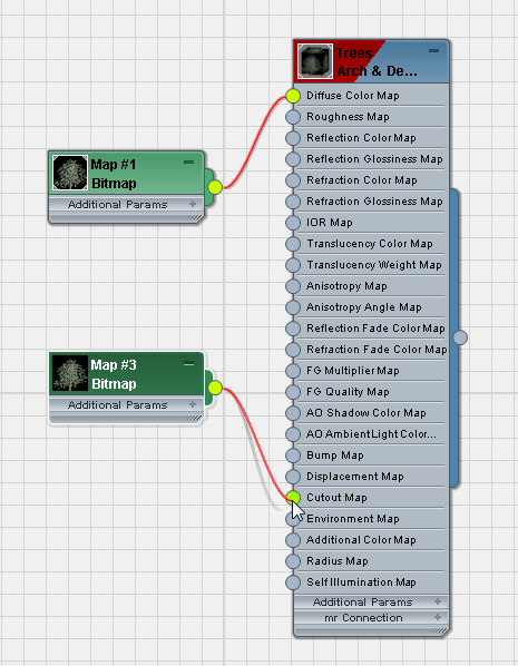

Use cutout mapping for the tree particles:
- In the Slate Material Editor,
+drag the Bitmap node to make a copy of it.
- Wire the new Bitmap copy to the Cutout Map socket of the Trees material node.
- Double-click the new Bitmap node so you can see the map parameters.

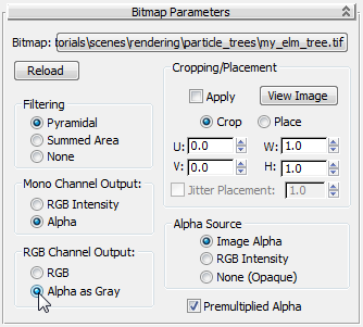

- On the Bitmap Parameters rollout, in the Mono Channel Output group, choose Alpha, and then in the RGB Channel Output group, choose Alpha As Gray.
Now the background of the tree bitmap no longer appears.

- In the Slate Material Editor, wire the original Bitmap node (the one you are using for colors, not for the alpha channel) to the Self-Illumination Map socket of the Trees material node.

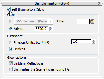

- On the Self Illumination (Glow) rollout, turn on Self Illumination.
At this point, the self-illumination has no real effect, because the default Luminance values are overpowered by the Daylight system exposure value set for your exterior scene.
- In the Luminance group, leave Unitless chosen, and enter a value of 5000.0.
