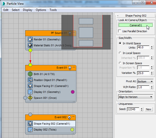

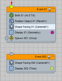

  1. In Event 001, click to highlight the Shape Facing 001 operator, then right-click it and from the pop-up menu, choose Copy.
  2. Right-click an empty area of the event-display area below Event 001, and from the pop-up menu, choose Paste.
    3ds Max creates a new event, called Event 002, with an operator that also instructs the particles to face the camera. Now you will modify this operator so that the particles will face the scene light source instead of the camera.
  3. Click the new Shape Facing 002 operator so you can see its parameters. In the Shape Facing 002 rollout Look At Camera/Object group, click the Pick button (which at first is labeled Camera01), then in any viewport, click the [Daylight01] Sun01 object.

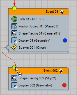

  4. In Event 002, click the Display 002 operator. On the Display 002 rollout, click the color swatch and use the Color Selector controls to choose a red color.
    This color is used to display the shapes of the second set of particles in wireframe views. It will not be visible in renderings. The red color will help you better identify the second set of particles.
  5. Open the Type drop-down list and choose Geometry.
  6. In Event 001, click the Display 01 operator and choose a dark blue color, to better see the first set of particles in wireframe view.
  7. Click the blue handle to the left of the Spawn operator and drag it to the Event 002 input (the empty circle that protrudes from the top of Event 002).
    With this connection, Event 001 spawns a set of particles once and sends them to Event 002, where they are instructed to face the sun.

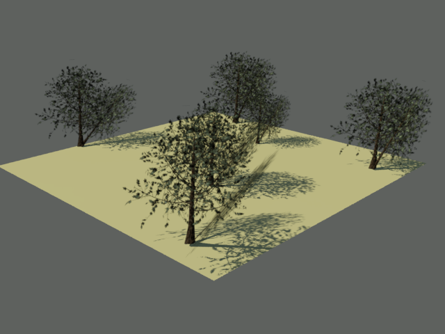

  5. Render the Camera01 viewport again.
    Particle trees with only one set of shadows visible
    The rendering shows one visible set of particle trees, and shadows cast by the second set of trees, which are otherwise hidden.
