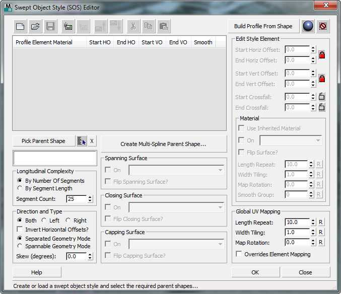

  1. From the Civil View menu, choose Civil View Swept Object Style Editor.

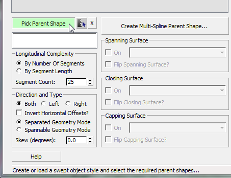

    3ds Max Design opens the Swept Object Style (SOS) Editor dialog.
  2. On the SOS dialog, click to turn on Pick Parent Shape.
  3. In the viewport, click to select one of the segments at either side of the bridge area. The name of the shape is C3DfeatLine-Link Road-Cyclepathout - Region (2). (You might have to move the SOS dialog to see this shape clearly.)
    The shape you have picked consists of two splines, one on each side of the roadway where the bridge will be.

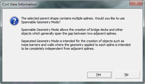

    3ds Max displays a dialog that asks which mode you want to use for the swept object.
  4. Click Yes.
    This dialog appears because the shape object contains more than one spline. In such a case, the Swept Object Style Editor can interpret the purpose of each spline in one of two ways. To generate objects such as bridge decks and tunnel linings, the Spannable Geometry Mode is desirable: This mode assumes that each spline represents either side of the road, and spanning and closing surfaces can generate "link" surfaces that span the gap between the splines. The alternative, Separated Geometry Mode, is more appropriate for creating noise barriers and retaining walls: For these kinds of features, the geometry of the swept object is applied individually to each spline in the shape.
    3ds Max Design begins to construct the bridge.

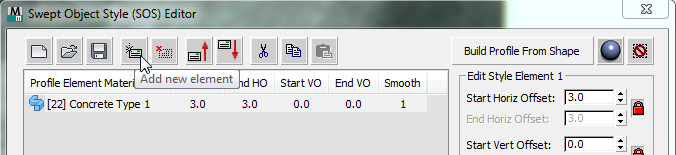

  1. On the Swept Object Style (SOS) Editor, click (Add new element).
    After you click this, some other buttons on the toolbar become active, and the new element appears in the SOS element list.
    In the viewport, you can also see the new element applied to each spline.

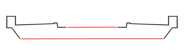

    Each element is a segment in the cross-section of the sides of the bridge. Because you chose Spannable Geometry, the elements are mirrored:
    Later, you use the Spanning Surface and Closing Surface options to create the roadway at the top of the bridge, and the bridge's bottom. The diagram shows these in red. (You also set up Capping Surfaces at each end of the bridge.)

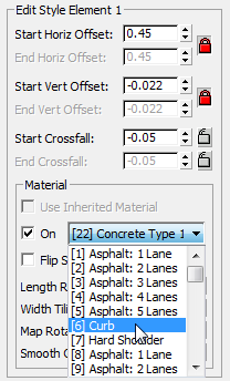

  2. In the Edit Style Element group, change the settings as follows:
    • Start Horiz[ontal] Offset: 0.45
    • Start Crossfall: –0.05
    • Material ID (use the drop-down list in the Material sub-group): [6] Curb
    Note: Because the Horizontal and Vertical Offsets are locked, the Start Vert[ical] Offset value changes as well.

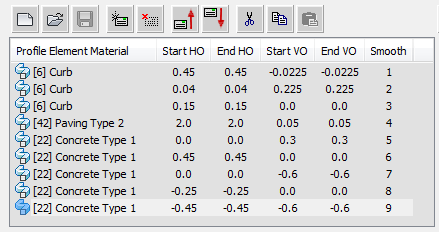

  2. One by one, click (Add new element) and add five new elements to the swept object style. Use the following table as a guide for the element settings.
    Element number Horizontal Offset Vertical Offset Material ID
    5 0.0 0.3 [22] Concrete Type 1
    6 0.45 0.0 [22] Concrete Type 1
    7 0.0 –0.6 [22] Concrete Type 1
    8 –0.25 0.0 [22] Concrete Type 1
    9 –0.45 –0.6 [22] Concrete Type 1
    When you are done, the element list should show nine elements in all.
